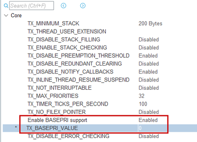

Try to configure ThreadX to use the BASEPRI register, as shown below:
set the 'TX_BASEPRI_VALUE' to a value different from 0, then the CAN interrupts won't be masked.
regards
Haithem.
