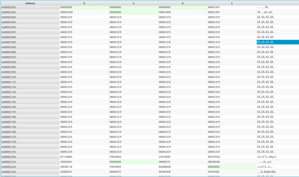

So, I still have a problem that the program is not jumping to the main program, but that's not the issue, the thing is, when I open the STM32CubeProgrammer and check the addresses I see some repeated information and I wonder if that's "normal".
The vector table, which is at the start of the program, typically has duplicate entries for interrupts that are not implemented as they all point to Default_Handler. That is normal.
