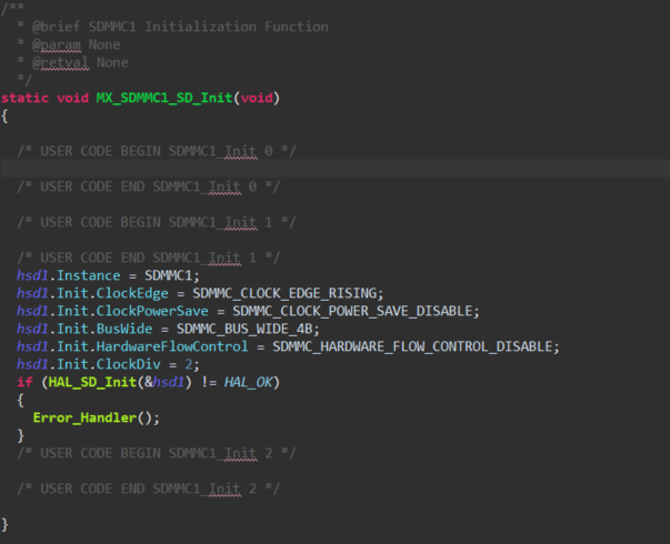

I believe there is an issue with the code generated by CubeMX for the fx_stm32_sd_driver.

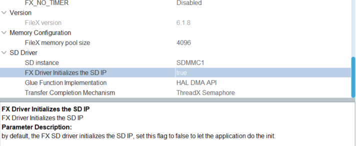

Config used :
In CubeMX, when I set the "FX Driver Initializes the SD IP" flag to true, the generated code wont compile as the MX_SDMMC1_SD_Init is generated static in the main, so the code below in fx_stm32_sd_driver.c is irrelevant...
#if (FX_STM32_SD_INIT == 1)
extern void MX_SDMMC1_SD_Init(void);
#endifOne solution is to remove the static keyword but every time CubeMX generates code, it comes back and it's kind of unpractical.
Could you please fix that in a future package update ?

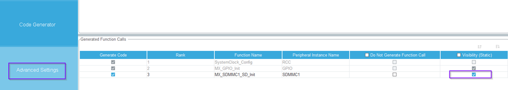

Hi @CGuil.1
Cpuld you please under the "Project Manager" panel, navigate to "Advanced settings" and uncheck the "visibility static" Option for the MX_SDMMC1_SD_Init()
regards
Haithem.

Hello Haithem,
Thanks for the answer, that works perfectly !
