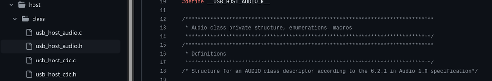

2025-03-16 2:07 PM
Maybe this could help you, for just to see, whats missing in the STM example and copy it :
2025-03-17 10:21 AM
From a brief read that does seem like it could be very valuable. Thank you for finding that I thought I had exhausted most of the results I get from searching but I must try harder. I will take a look at this tomorrow and see what I can gather from it.
