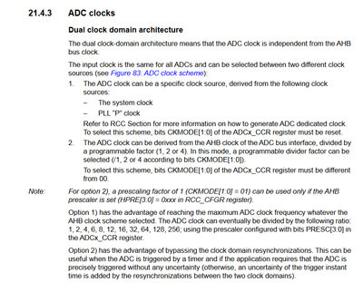

Can we use the asynchronous clock in the prescaler?
Is it valid to use 640.5 cycles with these parameters?
2025-01-15 2:32 AM

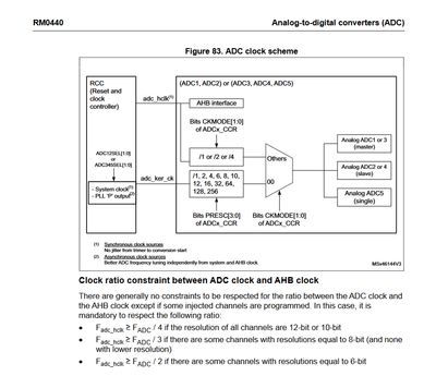

so you have the ADC probably running at a lower adc-clock, as you think you do.
See rm about the prescaler and the conditions you have to respect:
and some ...
