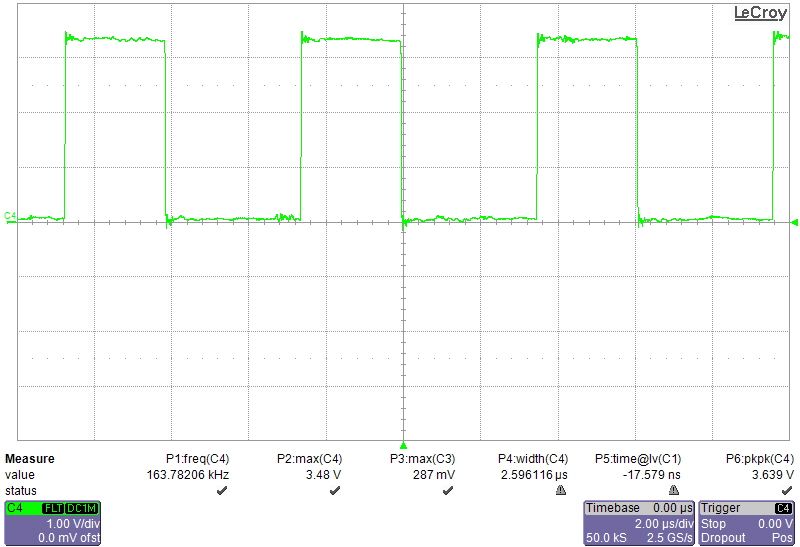

I agree that theoretical calculation may be wrong!.
Now as you the waveforms GPIO in the interrupt is toggling at the 142,8Khz attached image.
System clock is 170Mhz
please help in understanding how I got this 142.8Khz

Hello
I am also facing the same issue in the same board :D , my code looks like
while (1)
HAL_ADC_Start_IT(&hadc1);
HAL_GPIO_WritePin(PA9_GPIO_Port, PA9_Pin, GPIO_PIN_SET);
void HAL_ADC_ConvCpltCallback(ADC_HandleTypeDef *hadc)
HAL_GPIO_WritePin(PA9_GPIO_Port, PA9_Pin, GPIO_PIN_RESET);
adcBuffer = HAL_ADC_GetValue(&hadc1);
}ADC : 12 bit, single ended, 60Mhz(sychronous), ADC1 - IN1, 2.5 cycles sampling time, Fast channel
theoretically, it should be 250ns, but i am getti ng 2590ns
