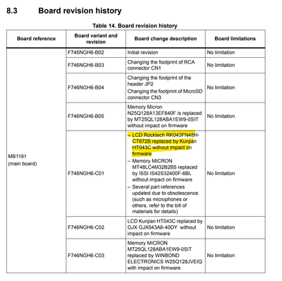

I urgently want to have an idea whether due to the change of LCD from HT043C KunJjian to RK043FN48H-CT672B Rocktech in 32F746GDISCOVERY Board, is there any changes in the firmware due to this?

According the UM1907 Rev 6 Table 14. Board revision history, LCD Rocktech RK043FN48HCT672B replaced by Kunjian HT043C without impact on firmware.

Thanks for clarifying, as this RK043FN48H-CT672B Rocktech is obselete hence can we change to RK043FN66HS-CTG Rocktech without any implication in the firmware of Discovery board?
