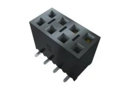

Hello @Glenn Andrews
CN2 connector of the STM32F746DISCOVERY is a SSM-104-L-DH:
I’m not a HW expert but you should be able to use standard connectors.

CN2 was defined to support pervious small memory daughter boards of ST, so it is not compatible with PMOD or other connectors.
As CN2 is a standard 2.54mm pin patch female connector, you can use four DuPont wires (male to male) to connect 3.3V/GND/SCL/SDA to other standard connector as flying wires. I think it is easiest way to transfer the connectors.
