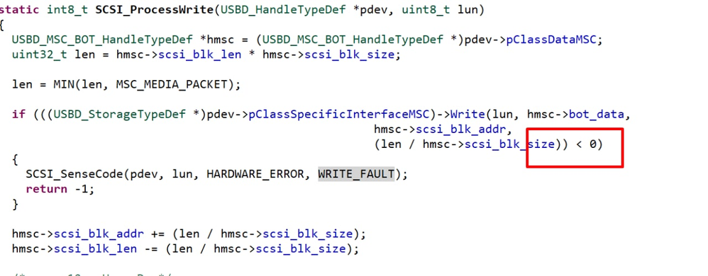

There is a bug in the ST code in the higher-up driver. It fails to support any return code other than USBD_OK.
usbd_msc_scsi.c

Why would that be a bug? Where are return codes of callbacks in USBD_StorageTypeDef documented, and why would they be USBD_***?

This is the usbd_storage_if.c generated by Cube for MSC that suggests the return code for the Write or Read functions should be USBD_OK or USBD_FAIL. The USBD error codes are positive values but the SCSI_ProcessWrite() in usbd_msc_scsi.c only tests for negative return values and consequently will ignore any error. This is surely a bug!
Even the very latest ST code has the same bug.
So that's some code generated by CubeMX? How does that suggestion look like? I don't use CubeIDE/CubeMX.
As far as I can tell, the example projects in Cube clearly indicate that 0 is OK and -1 is fail, e.g. here https://github.com/STMicroelectronics/STM32CubeF4/blob/4aba24d78fef03d797a82b258f37dbc84728bbb5/Projects/STM324xG_EVAL/Applications/USB_Device/MSC_Standalone/Src/usbd_storage.c#L169
