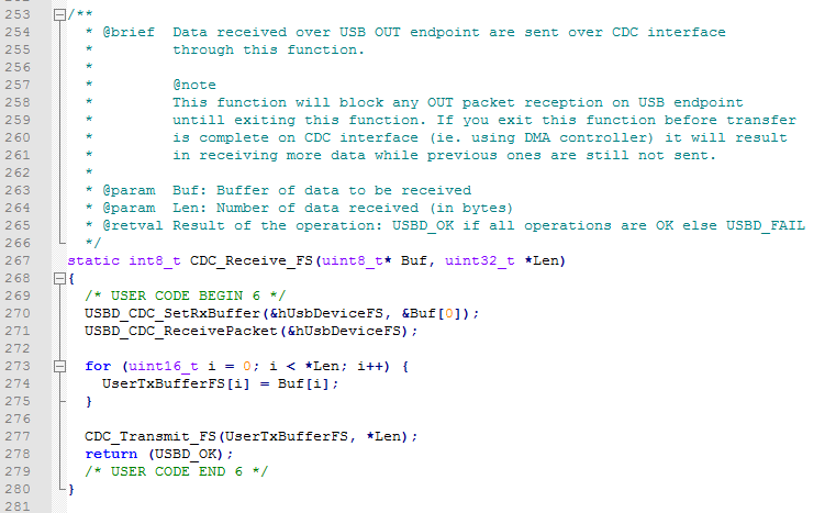

I have a simple RTOS task which copies in data to output. That is where I see the corruption.
It is entirely fixable by disabling certain RTOS tasks! But the ones which "fix" it don't do anything related to USB. I am thus suspecting there is a critical region which is unprotected and RTOS related task switching messes it up.

I think USBD_CDC_ReceivePacket(&hUsbDeviceFS) is supposed to go after the copy loop.

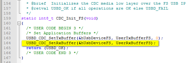

This is the init code
and that buffer was 2k, not 64 bytes, so not sure what the intention was there.
I just looked up some code from a year ago, which may be the original.

About the CDC_Receive_FS() code...

"Why the data copy is implemented as a custom loop instead of a memcpy() call?"
No idea but now it is moving the USB block (1-64 bytes for CDC) to a 1k circular buffer which could be done with memcpy (there are several cases to handle when moving linear to circular) but normally isn't. Performance here isn't a big fish to fry, especially when you look at how far the data travels in USB already. These multi block transfers are low priority on USB anyway.
