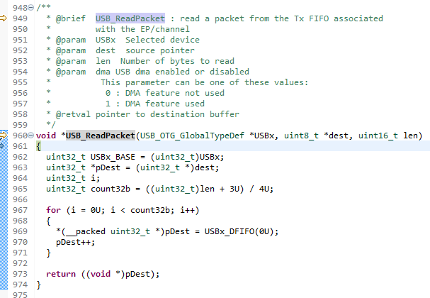

This is the function
I can see this reads the (64 byte?) USB FIFO into a buffer. However, it is getting called all the time, possibly because it does both MSC and CDC, and Windows is polling the MSC device at about 1Hz all the time.

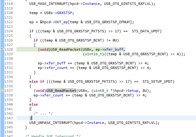

This is the debug stack before the breakpoint gets hit
There are only two lines in the project where usb read packet is called and this shows line 1328
I will try to get the content of that buffer when the corrupt data is seen.

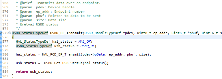

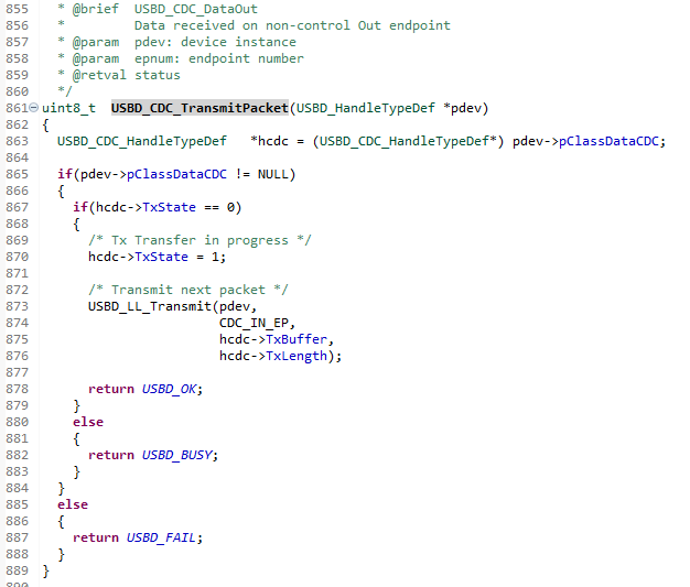

So I went to look whether one can disable interrupts during output (either USB, or all using the "critical" macro). This is the function used to transmit
and USBD_LL_Transmit is not easy because it is called constantly by MSC
I think if I put in code in this one which I can breakpoint on if it gets called with a non MSC packet, that might do it, but I don't know how.

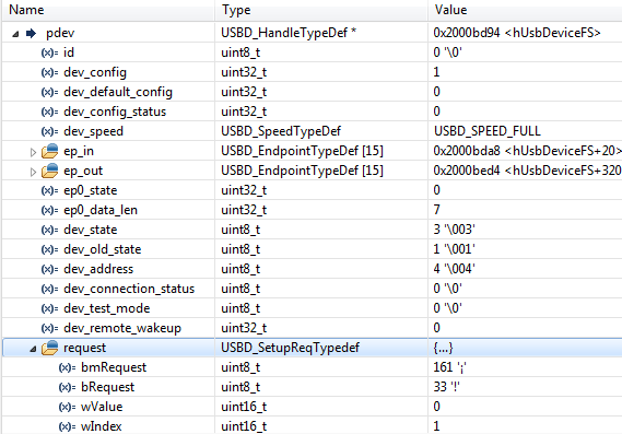

This is pdev for MSC:
I suspect the id=0 refers to the single USB port.
