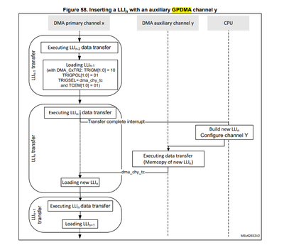

I believe that would only work for the internal ADC. Sorry I should have clarified that it is an external ADC that sends a DRDY back to the MCU when the conversion is completed. (Conversion is handled internally to the ADC). What I have been trying to do is use the DMA LL architecture to do the following.
1. Configured DMA:
Thus far I am unable to get the SPI message to trigger using this approach. I am able to see clock signals if I manually start the SPI message using the HAL_SPI_Receive_DMA(&hspi1, data, 4); command or by manually changing the SET_BIT(hspi1.Instance->CR1, SPI_CR1_CSTART);.
Thus far I am unable to get the DMA to cause any SPI message to be originated head-lessly from the DMA. I have also tried using a 1 node chain for the LL that is the SPI RX that contians the trigger but reading the User Manual it seemed like a n-1 node was required for the pause to execute correctly. (User Manual RM0456 698 - 700)
