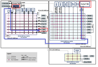

2024-02-01 8:46 AM
There is no relation between cache and QuadSPI XIP mode.
Cache is part of cortex M7. No Cache from CM4 side but ART accelerator:
The line I drawn in purple is the path of CM4 access to QSPI through different stages including ART. So no Cache in the path.

2024-02-01 8:46 AM

2024-02-01 8:48 PM
How do i access the ART ??
2024-02-02 12:24 AM - edited 2024-02-02 12:26 AM
Add this lines at the start:
__HAL_RCC_ART_CLK_ENABLE(); /* Enable the Cortex-M4 ART Clock */
__HAL_ART_CONFIG_BASE_ADDRESS(0x90000000UL); /* Configure the Cortex-M4 ART Base address to the QSPI */
__HAL_ART_ENABLE(); /* Enable the Cortex-M4 ART */
Note that the accelerator covers only 1Mbyte from the start address.
