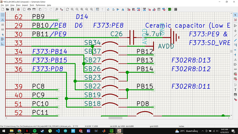

Sorry for my insufficient information. When I look at that the schematic of Nucleo boards, I found a lot of circuit breaker under SB symbols. Normally I didn't see anything like that in other microcontroller, so I'm wondering what is the purposes of that circuit breaker?

here it's. the symbol is SB.

SB stands for Solder Bridge.
In some cases, it provides alternative usages of pins, e.g. whether a Tx pin goes to the on-board STLink's VCP Rx pin, or to an external pin.
Also The board (PCB) itself is rather universal, and ST places several different target STM32s onto it; however, these mcus are not 100% pin compatible and the SBs solve this - for different mcus different set of SBs is closed.

Thanks you, So it's only to select the pins for different peripherals.

Yes, like links/jumpers on other boards, but taking less space and parts to implement.
