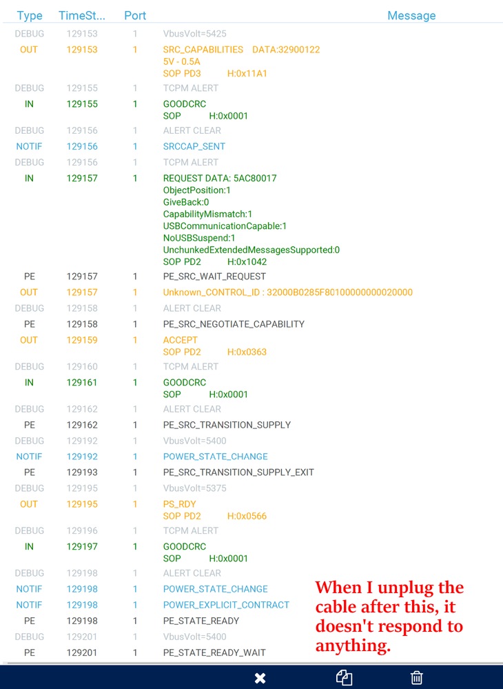

When the device behaves as a source, unplugging the cable after the state shifts to PE_STATE_READY_WAIT does not cause a detach event.
After this, the device will not respond to anything. However, it does not appear that a HardFault has occurred. The alert is left in place as it occurs.

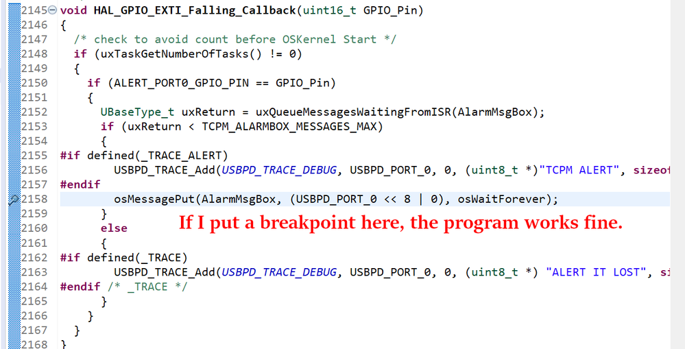

However, if you put a breakpoint in the handler of the alert detection, it works fine.
That leads me to believe that the problem is related to something timing related.

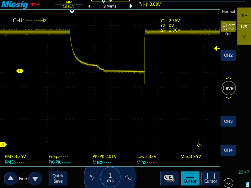

As soon as I unplugged it, the DCDC converter on the 5V line was outputting an overvoltage.
This would cause the DC converter on the 3.3V line to be temporarily disabled.
Maybe the FUSB307B couldn't be accessed while the voltage on the 3.3V line was down. I think so.
Thank you for your help so far.
3.3V line when unplugged from the USB plug​ (Power supply for FUSB307 and MCU)

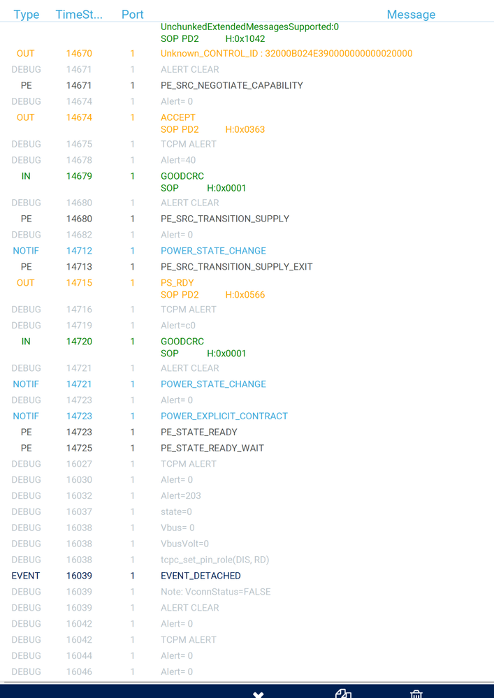

* with_break_points.cpd
In this trace, I can see clearly the detach after 7secs. For me, in this log, you managed to detach cable.
Do you mean that you put the breakpoint and then you ran again the application? In this case, you saw the detach?
-pe - 0000041623 P0 PE_STATE_READY_WAIT
debug 0000048548 P0 DEBUG0 "TCPM ALERT "
debug 0000048548 P0 DEBUG0 "Alert=203   "
debug 0000048554 P0 DEBUG0 "state=0     "
debug 0000048555 P0 DEBUG0 "Vbus= 0    "
debug 0000048555 P0 DEBUG0 "VbusVolt=0  "
debug 0000048555 P0 DEBUG0 "tcpc_set_pin_role(DIS, RD)"
==== 0000048556 P0 EVENT_DETACHED ====

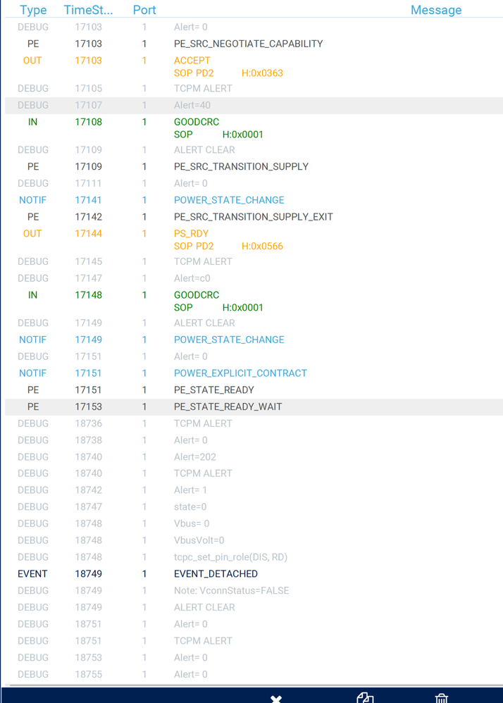

I never detected such issues. For tests, you try to add a delay in 'fusb305_tcpc_alert' function and check if you are able to read a status change in alert register:
USBPD_StatusTypeDef fusb305_tcpc_alert(uint32_t Port, uint16_t *Alert)
  USBPD_StatusTypeDef usbpd_status = USBPD_OK;
  /* Start a delay before reading ALERT register */
  USBPD_TCPCI_Delay(1); // 1ms, you could increase it step by step
  /* Read the Alert register from the TCPC */
  usbpd_status = USBPD_TCPCI_ReadRegister(Port, TCPC_REG_ALERT, (uint8_t*)&state[Port].Registers.Alerts.word[0], 2);
Regards,
Yohann
I inserted a 1ms delay code before and after the register reading process in the fusb305_tcpc_alert function.
It recognized the detach successfully in both cases.
Hi Yohann​
I found the cause of the problem.
The power supply was the cause.
