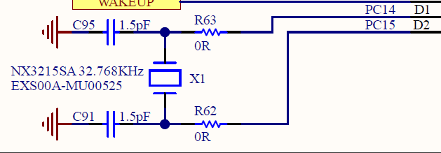

STM32H7B3I-DK - Discovery kit use NX3215SA-32.768KHZ-EXS00A-MU00525 Crystal. Crystal Load Capacitance is 6, 9, 12.5 pF but STM32H7B3I-DK - Discovery kit use 1.5pF. Why it use different load capacitance.

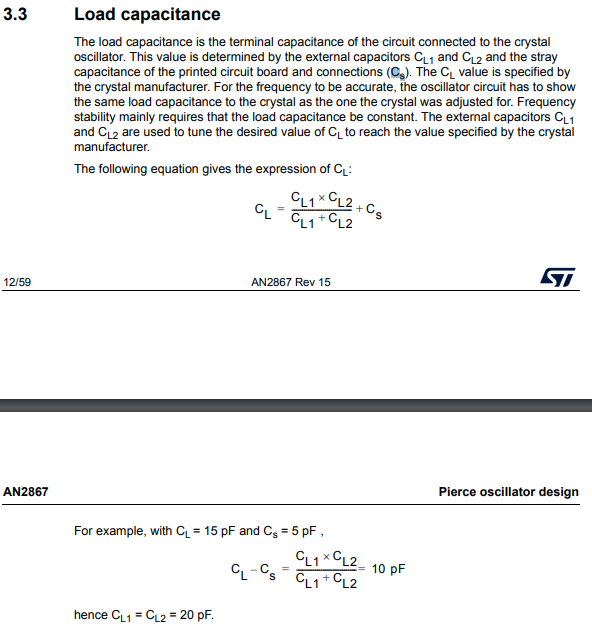

That quote doesn't even answer your question about the capacitors.
I'll tell you a secret - to understand a load capacitance, you should at least read the section called "Load capacitance"!
2022-03-30 6:50 AM
Hi @Piranha Load capasitans inclueds a formule. How we know the stray capacitance (CS) value? Should we choose an estimated value? Can we know its real value?
