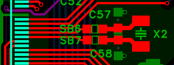

Hardware layout below
waclawek.jan
Super User
Often the problem is ground. A solid ground layer is not a solution, if there are high currents flowing through it; rather, a separate ground connection to VSS pin closest to crystal pins is better.

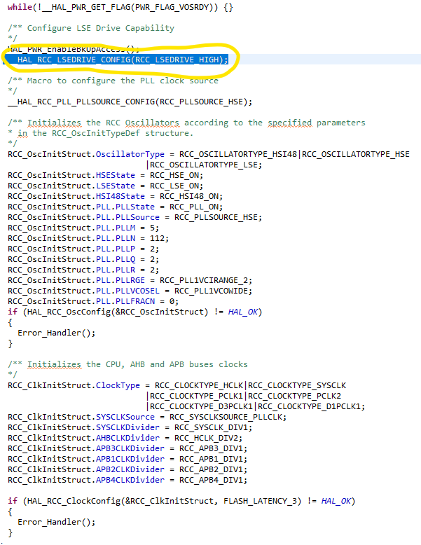

Hi @Community member​ I tryed 4 options. But RTC clock lag resume. I see at 5 minutes about RTC clock late 2-3 seconds

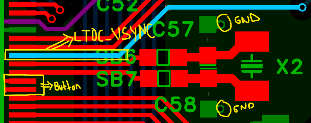

Peter BENSCH
If you can't get a clean working LSE clock with the crystal and your layout, you should indeed feed in an external 32.768kHz clock (bypass mode) as JW wrote.
As you wrote, you have no additional shift of the RTC during the off-time, which speaks for interfering signals during the on-time.
If you are successful with the external clock, you can start improving the layout, because I have a strong suspicion that at least the very dense and unshielded VSYNC signal is coupling in and causing you these problems.
AN2867 shows some sample layouts that you can use as a guide. For example, you can take a closer look at the GND routing in section 7.2, paying special attention to the separation of the GND area under the crystal and its passive components, as well as the connection of this separated GND area to the GND pins next to the OSC pins (in the example of fig 14, this is an STM32 in a UFBGA176 package).

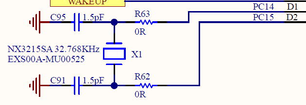

Freedom_Neo
Senior
I have another question. STM32H7B3I-DK - Discovery kit use NX3215SA-32.768KHZ-EXS00A-MU00525 Crystal. Crystal Load Capacitance is 6, 9, 12.5 pF but STM32H7B3I-DK - Discovery kit use 1.5pF. Why it use different load capacitance.
