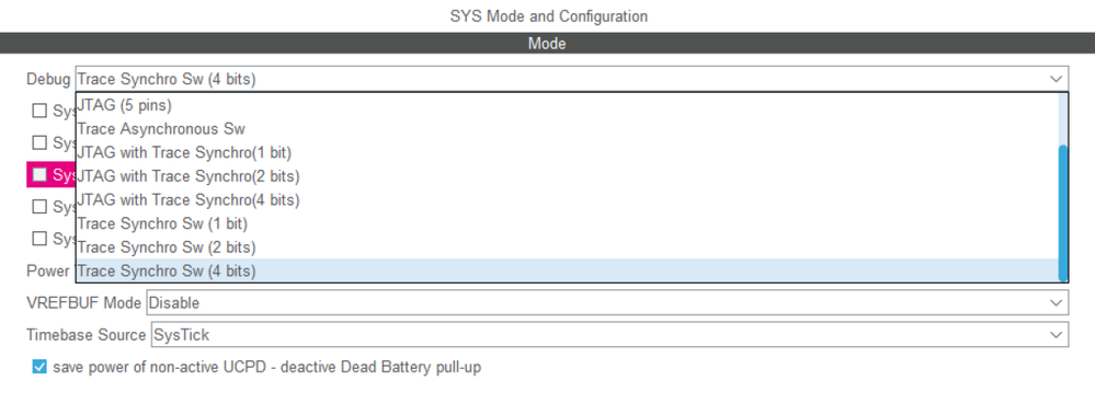

Segger J-Link (Debug / Trace) seems to be the right choice here. However, I have not yet found whether one of these debuggers also supports these additional data lines "TRACEDATA [3:0]" of the TPIU.
These can be configured in the CubeMX and I assume it is these additional 4 tracepins for a data communication.
https://cortexprog.com/ looks interesting, will this be developed further?
