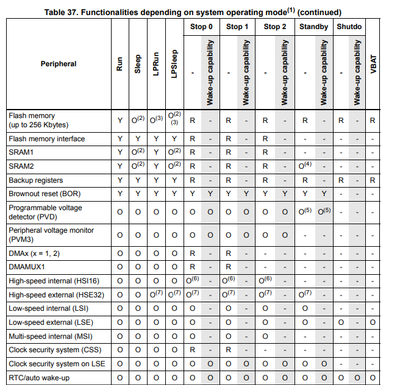

2025-08-05 6:38 AM
Hello @Eldryad,
1. As you can see from this table, the RTC wakeup capability is optional in stop2 mode, which clock source are you using for it?
2. If you check Table 37 of the RM0461, you can see that the SPI is not functional in the Stop2 mode, so after wakeup, you'll need to reinitialize it
3. Same for Sub-GHz/SPI stack, it's not available in Stop2, it can be retained in Stop0/1 only.
Hope that helps!
