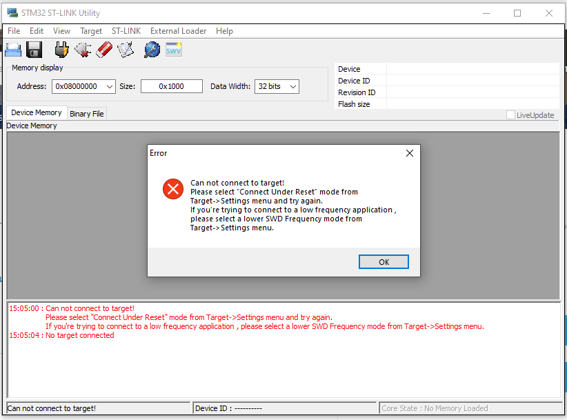

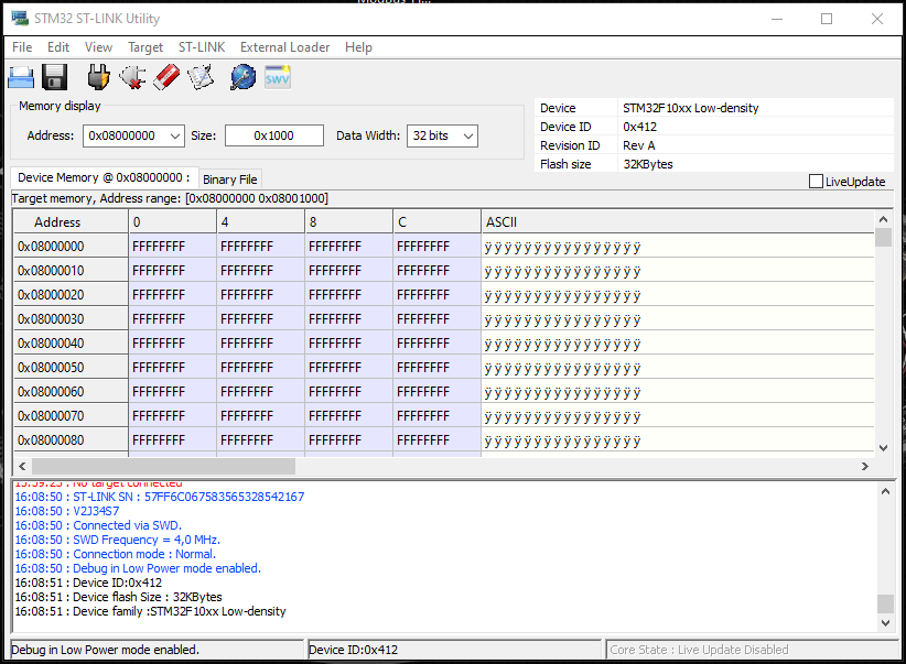

When i try one controller(stm32f103c8t6) its show details like this .When i connect other controller(stm32f103c8t6) its show the error like this. Please some one help to resolve this error.

Does you application use sleep modes, re-purpose the JTAG/SWD pins, or activate readout protection ?
Try a mass erase.

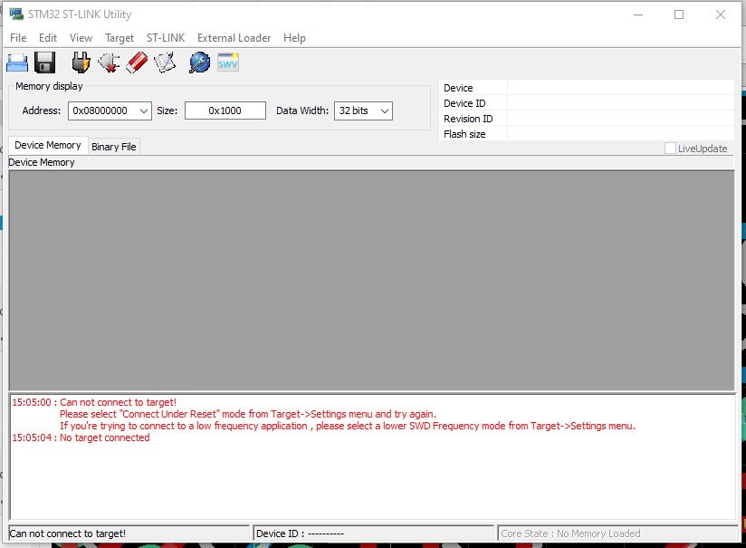

when i try to read first time its show the device id ,memory &ram After some time its show the error like this
