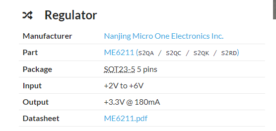

I am also a bit confused about whether I can power the board with 5v. As I stated earlier, the datasheet says not to exceed roughly 4v. However in the image below that source states there is a regulator that supports up to 6.0v.
So can I power the board with 5v after all?

You are confusing a few things here: the AN4488 refers to designs that use an STM32F4 directly.
But you want to use the MiniSTM32F4x1 board from WeActTC aka BlackPill, which is actually designed to be powered via USB or the 5V connector.
If you do not use the 3.3V connection to supply smaller external loads, but to feed in the 3.3V, you could run into unforeseen problems. This is because you are operating the LDO AP7343D-33FS4-7B backwards, since the p-fet it contains usually has a parasitic antiparallel diode with an anode at the regulator output. This diode path conducts as soon as the output has a higher potential than the input - i.e. when 5V is open.
By the way, this LDO can handle voltages up to 5.25V.
