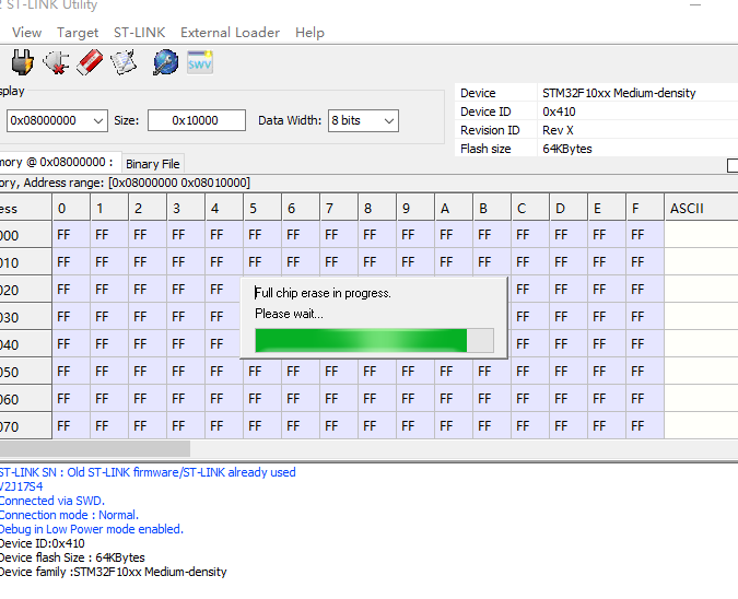

08:49:24 : V2J17S4
08:49:24 : Connected via SWD.
08:49:24 : Connection mode : Normal.
08:49:24 : Debug in Low Power mode enabled.
08:49:25 : Device ID:0x410
08:49:25 : Device flash Size : 64KBytes
08:49:25 : Device family :STM32F10xx Medium-density
08:54:32 : Error occured during flash mass erase!
08:58:43 : Disconnected from device.
08:58:43 : Connection to device is lost: check power supply and debug connection.

Lacking any contextual detail.
Probably conflicting with prehistoric firmware on the ST-LINK, perhaps try updating that first.
Some custom board? Could perhaps have issues with flash if power supply inadequate.
2019-09-17 12:51 AM
yes custom board, power supply should be enough , after we replaced a MCU , then no issue
only one out of 300 happened
