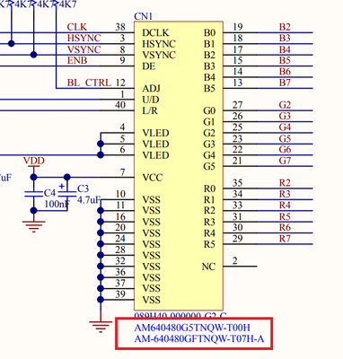

- the screen model on the eval board ( I couldn't find the model in the STM32H753-EVAL2 reference manual)
- what configuration parameter could cause the "blinking" of a fixed image ?
From the board user manual UM2198 page 57:
AMPIRE LCD panel: AM640480G5TNQW-T00H or AM-640480GFTNQW-T07H-A

Thank you, my LCD clock setting was wrong.
