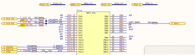

Hi @KDJEM.1 @Tesla DeLorean ,
It seems like the issue is in the Nucelo board pin connections, refer to the schematics for this. PA2 and PA3 are not connected to the MCU, there is no resistor connected across that pin signal.
So we have mounted the SB17 and SB23 across the ARD_D0 and ARD_D1 pins. And now it is working fine, we were able to read the Device ID.

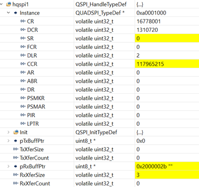

Picture 1:
This shows the register values after QSPI Init.

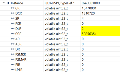

Picture 2:
This is after the QSPI_Command is passed.

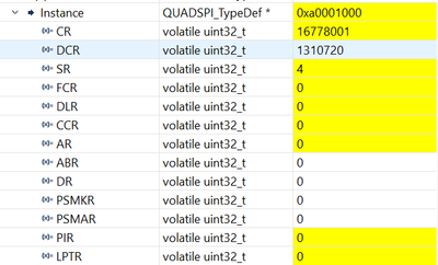

Picture 3:
This is after the QSPI_Receive function.
The same code gives the output when tested with STM32L412 Nulceo board. But no response when tested with the STM32G474 Nucleo board.

Try doing this WITHOUT doing LIVE inspection of the QSPI registers, likely to mess with status, data and FIFO operations. It's very invasive. If you need to understand flow, and internal state, print diagnostic/telemetry to a terminal.
