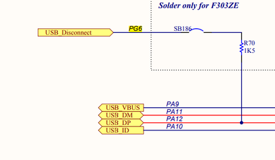

I found:
Set PG6 (USB_PowerSwitchON) to High (Low by default) and it works:
This part of the scematic gived me the clue:
BR

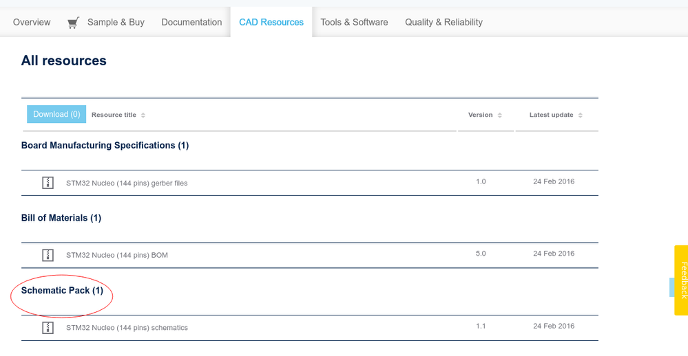

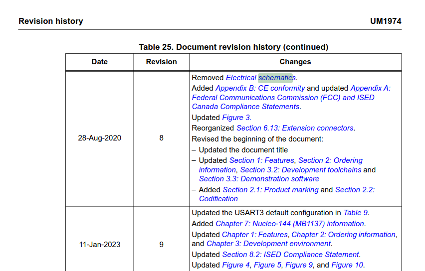

2023-08-03 2:06 PM
I tried to see the schematic of the board to try to understand how it works, but unfortunately the ST is going against the grain.

2023-08-04 2:12 AM
@le-gal.guillaume wrote:Hello,
here is the schema:
BR
Thanks, I opened a question about the schematic, now the schematics are available in the CAD Resources tab.

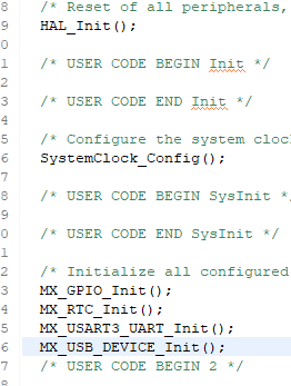

By the way, is it normal that USB_DP is at 0 after MX_GPIO_Init()?
The piece of code in MX_GPIO_Init() where USB_DP switch to 0:
BR
2023-08-04 4:49 AM
I found:
BR
