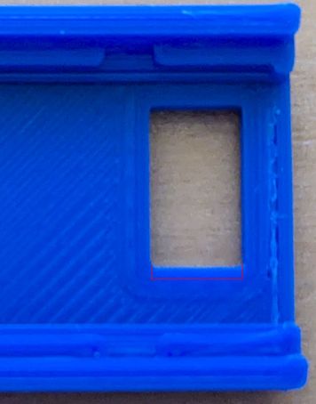

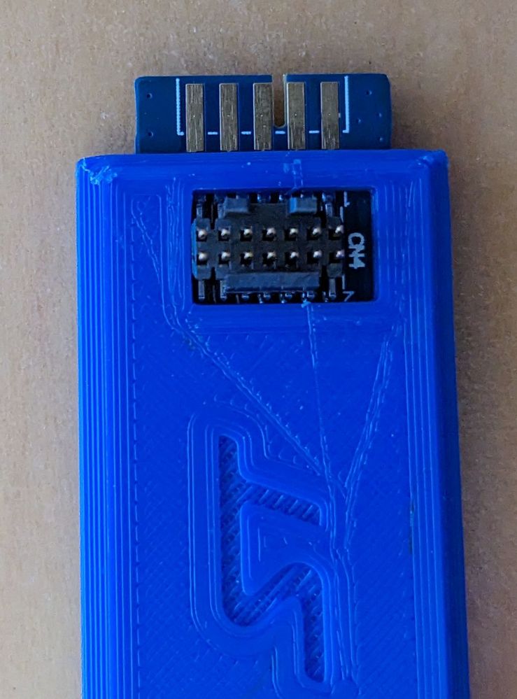

Kudos and thanks to the ST dev-tool team for making an enclosure STL file available (on the product page under CAD Resources) so users can print enclosures for the STLinkV3-MINIE.  This post is just to help others with print settings so they don't have to experiment as much as I did.
There are only two real problems I encountered:
  1. The opening for the STDC14 connector is not centered in the enclosure as it should be; as a result, after printing, you must cut a significant amount of material from one of the short sides of the opening before the board can be inserted flat with the STDC14 connector going through the opening.  (you can see where I had to cut in the photo below).
  2. When slicing the STL file with Cura (probably the most popular slicer), you need to uncheck the "Union Overlapping Volumes" box in the Mesh Fixes section of the print settings.  If you do not, then the hole for the STDC14 connector is filled in by the slicer and the enclosure is unusable.
Otherwise, printing is straight-forward.  I've printed several using PLA (at 200C) directly on a heated (60C) glass bed using only glue stick for adhesion.  I use 20% infill density and do not use supports or any other adhesion aids (brim, skirt, etc.).

Thierry GUILHOT
I would like to thank you for reporting us this issue with the casing and all recommendations. Before publishing a new zip package, I'm wondering if you would confirm us that the attached .stl file is answering to your need. We've tested it and we consider it is all right but getting your approval would be more than welcome.
Please note that we are also considering your other feedbacks regarding the different files to share.

For the connector opening which is not centered, my guess is the designer wanted the "CN14" reference to be visible.

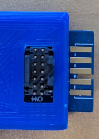

Many thanks for the quick response @Thierry GUILHOT, I will print it now and post the results.
@Thierry GUILHOT
Perfect!
Thierry GUILHOT
Thank you for the feedback. May I ask you what is the board revision of your STLINK-V3MINIE (MB1762-V3MINIE-xxx)? I want to double check one point.
Thank you @Thierry GUILHOT.  Most are very recently purchased and are MB1762-V3MINIE-B01.
