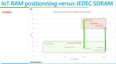

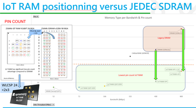

APMemory PN with "XX' (like APS512XXN-OBR or APS256XX-OBR) are supporting both OPI & HPI mode. The device is booting in x8 and can be swap to x16 by mode register. The command you mentioned are setting the configuration on the MCU side.
The benefit of using HPI x16 mode are following:
Below are illustrations of pin count & power benefit of OPI versus SDRAMx16 & HPI versus SDRAMx32
Hope this help
