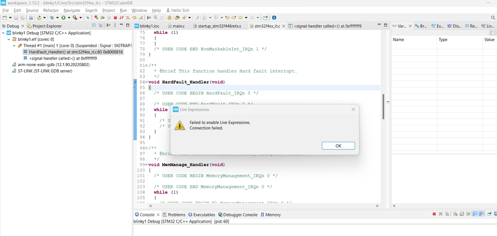

I tried setting up Nucleo board, and every time I debug the code, it goes to HardFault_Handler(). How do I solve this?
I assumed there could be a debugger issue and I tried all the firmware for ST Link. No luck. Can anyone help?
