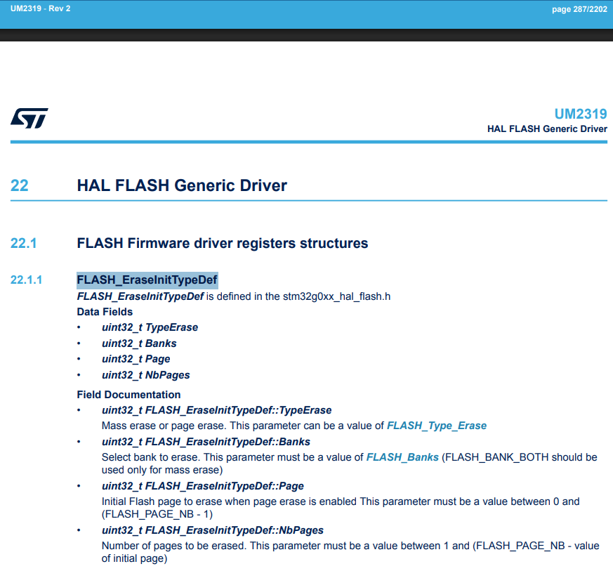

When you initialize a structure in its declaration, the fields which are not initialized explicitly are initialized to zeros. It's a common mistake in STM32 ecosystem to declare the structure without an initializer inside of a function, then to assign some fields - the remaining fields then have some random values, causing the call to fail or behave strangely. Unfortunately, many ST offcial examples suggest this to the programmers by setting the fields with a series of assignments instead of initializing them in the declaration.

@jo512 wrote:I will have to erase around 50 pages. How do I do this? Should I make an array or 50 variables, initialize it statically
You can re-use one structure.
@gbm's point was to ensure that there are no uninitialised fields in the structure.
PS:
As @TDK suggested, you can see the definition of the FLASH_EraseInitTypeDef in the source code.
It's also in the User Manual for the Firmware Pack:
via: https://www.st.com/en/embedded-software/stm32cubeg0.html#documentation
via: https://www.st.com/en/evaluation-tools/nucleo-g0b1re.html#tools-software
So, with your original code:
/* Prepare erase configuration */
erase_init.TypeErase = FLASH_TYPEERASE_PAGES;
erase_init.Page = page_index;
erase_init.NbPages = 1;you leave the .Banks field uninitialised.
With this code:
FLASH_EraseInitTypeDef erase_init = {
.TypeErase = FLASH_TYPEERASE_PAGES,
.Page = page_index,
.NbPages = 1
};the the .Banks field at least gets initialised to zero - but that still may not be correct...

Did you try:
erase_init.Banks = FLASH_BANK_1;or
erase_init.Banks = FLASH_BANK_2;depending on where the page to be erased is.
Flash is 128 pages per bank. See "3.3.1 FLASH organization" in the reference manual.

So did properly setting erase_init.Banks help ?
2025-10-20 4:12 AM - edited 2025-10-20 4:15 AM
Hi All
As expected
.Page = page_index,
.NbPages = 1
};did not work, but setting the bank to 1
seems to work
