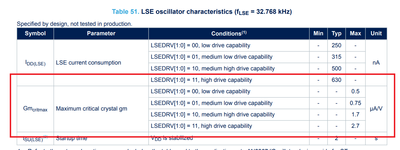

This is the Gain margin provided in the datasheet:
Maximums specified by design, not tested in production.
You need to select the correct drive level based on the crystal characteristics. Please read How to select a compatible crystal and load capacitors for STM32 with layout guidelines / Section  2. Calculation to validate the crystal compatibility with STM32
So for each drive level you need to do the same calculation until you find the correct drive level suitable for the crystal.
For the NUCLEO-U083RC board / NX2012SA-32.768KHZ-EXS00A-MU00527, I let the board's designers answer that question.

Drive levels are not specified in chapter 6.3 of the datasheet. So as there is no maximum drive level listed, there is no guarantee.
