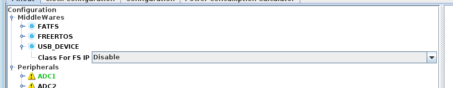

If I generate my project with Disabled USB class:
I can debug it fine with STM32 Workbench and openocd:
