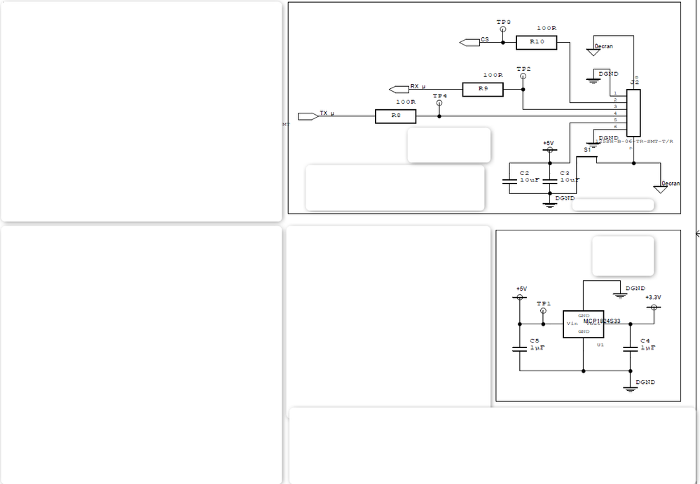

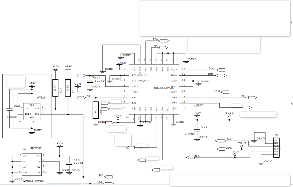

I am working on a custom board using a STM32F030K6T6. We are already in production and on like 15 parts over 4000, after that the product passed the electrical tests in production, and most of the time, after then, we tested it manually using a FTDI RS232 to establish a UART connexion, it appears that it stops communicating (so, after it first works well).
I first thought it is something linked to the fact that we plug the FTDI cable to establish the communication, as maybe an ESD, but in this case, it wouldn't work again after the capacitor removal.
Here is the schematic:
Note: the J1 connector, which is for programmation (used only in production) is not accessible from the outside, The pcb is inside the casing.
So if you have any idea about what's going on, a design remark on the schematic, or best, already seen that, it would be really great and helpfull !
