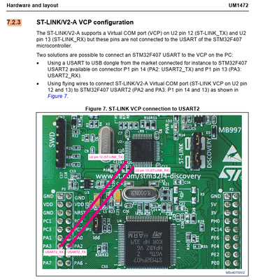

in the STM32F407G-DISC1 ,the ST-Link embedded in the F407 discovery is not wired to a target MCU UART, so it has no virtual COMPORT capability.(the physical connection is missing.) you will need to add physical link wires to the Discovery board or connect to a separate USB-to-UART adaptor.
Maybe this is your issue.

@Gyessine wrote:the ST-Link embedded in the F407 discovery is not wired to a target MCU UART, so it has no virtual COMPORT capability
It does have the VCP (Virtual COM Port) capability in the ST-Link itself - it just lacks the physical connection from the ST-Link to the F407 Target MCU

thanks for mentioning the USB to UART converter we used one and it worked
