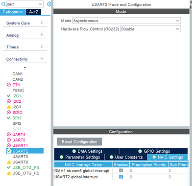

I am a beginner, and this is my first time trying to use UART to send data from MCU to PC.I try to follow the deep blue embedded tutorial (STM32 Serial Print & Monitor (UART Data Debug), however the console does not receive anything when I connect to it.
This is my main function code

}These are my UART2 settings.

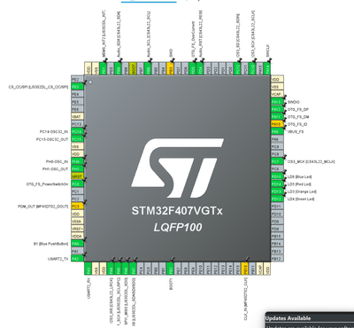

These are my pins.

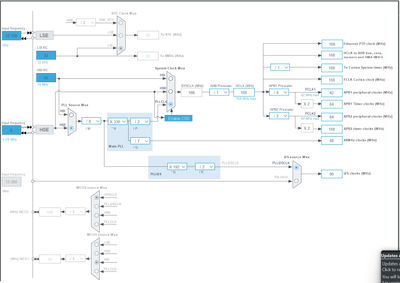

This is my clock configuration.
What should I change so that UART sends the data correctly?

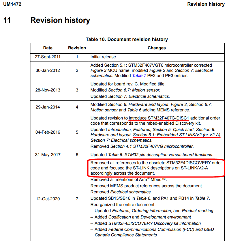

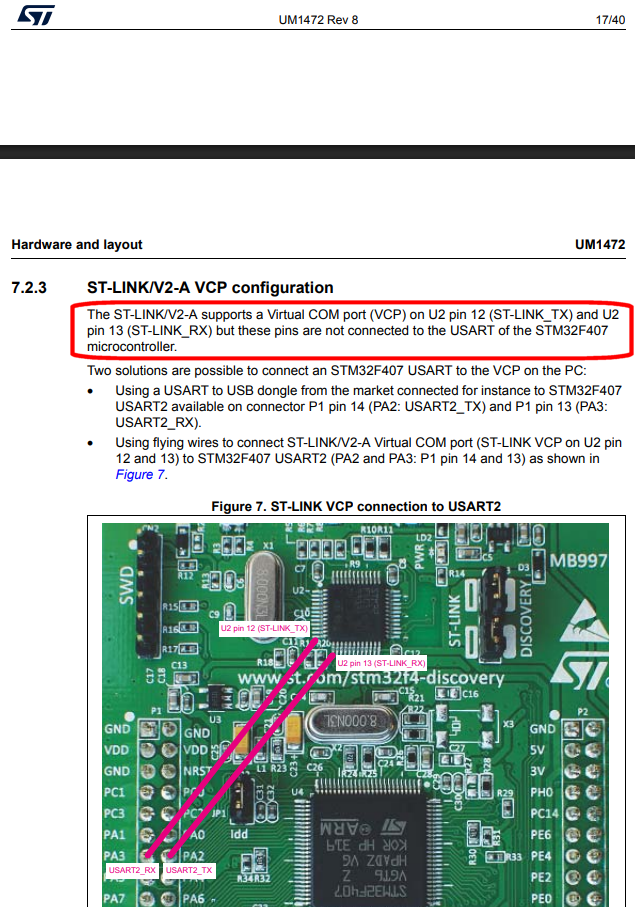

2025-09-11 5:03 AM - edited 2025-09-11 5:03 AM
@Ozone wrote:If I remember correctly, the ST-Link embedded in the F407 discovery is not wired to a target MCU UART...
This is true.
@Ozone wrote:... and thus has no VCOM capability.
This is not true.
The Virtual COM Port (VCP) capability is there - it's just the physical connection that's missing.
@cockatoo This is described in the User Manual:
via: https://www.st.com/en/evaluation-tools/stm32f4discovery.html#documentation
2025-09-11 5:07 AM - edited 2025-09-11 5:09 AM
@cockatoo wrote:I didn't know.
See above - it is documented in the User Manual
@cockatoo wrote:What should I use if I need data transfer between PC and F407 discovery if there is no UART?
There is a UART (in fact, the STM32F407VG has four UARTs) - what's missing is just the physical connection from the UART to the PC.
As described, you need to provide that physical connection.

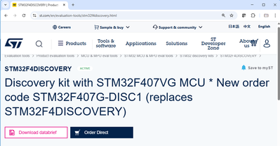

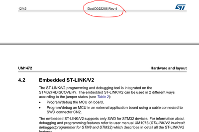

2025-09-11 6:23 AM - edited 2025-09-11 6:25 AM
Maybe that's the difference between the OP's DISC1 and the original DISCOVERY?
PS:
Indeed, it seems so:
So they updated the ST-Link to add VCP Capability, but didn't update the board to take advantage of it!

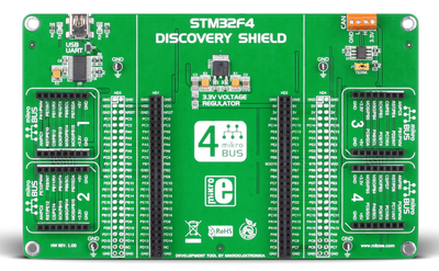

2025-09-11 8:55 AM
Just like @Ozone, my Discovery board is the older version.
This Mikroe shield board has been great to use and has a built in USB connector to USART2 and a connector to CAN1
https://www.mikroe.com/stm32f4-discovery-click-shield
