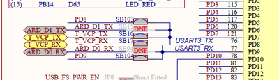

It seems not. From the schematics, USART3 instance is the one that should be used (if VCP used) with PD8 for Tx and PD9 for Rx.
So the question here, @Pincate are you using an externa USB/UART converter connected externally to USART2? if not, you need to use USART3 (PD8 for Tx and PD9 for Rx) and the STLINK VCP.

So, presumably, you are trying to use the Virtual COM Port (VCP) in the Nudleo board's ST-Link?
@Pincate wrote:I am using suart2 with PA2 as the TX, and PA3 as the RX.
Are those pins actually connected to the VCP?
See:
