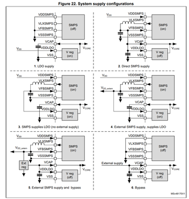

This is the one used in design. received from hardware team.
No. This is a 24V power supply.
I suggest you to get back to your hardware team and check with them what power configuration they adopted in the board for STM32H7?
