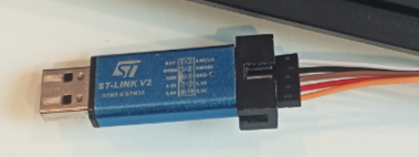

Yes I have use the authentic St-Link.yes when I connect the st-Link to my system i my system device manager shows only  Universal Serial Bus device (STM32 STLink).In Port option com port didnot show anything.Yes i have use the Stm32 Cube Programmar i have spaced same issues on Stm32 Programmar likewise.You have to tell the step by step procedure for set the ST-Link correctly.I have attached the My STM32F407VET6 development with ST-Link orginal picture Below.
No, that is not a genuine ST-Link - that is a clone:
These are genuine ST-Links:
https://www.st.com/en/development-tools/st-link-v2.html
https://www.st.com/en/development-tools/stlink-v3set.html
See this document for details of the full range:
https://www.st.com/resource/en/technical_note/tn1235-overview-of-stlink-derivatives-stmicroelectronics.pdf
Beware that these fakes can have differing pinouts:
https://community.st.com/t5/stm32-mcus-products/debug-problem-with-clone-st-linkv2/m-p/661306/highlight/true#M240845
Are you sure you've got the connections correct to match the particular clone that you have?
These clones don't have any Virtual COM Port (VCP).
