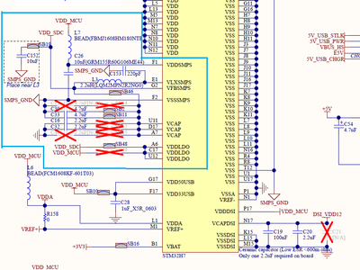

This is the part of Schematics for SMPS config (in blue) from STM32H747 DISCO schematics :
So, double check with your schematics.

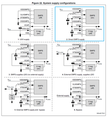

From RM0399:

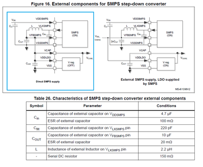

From DS12930:

Hello @Iris-DM ,
From RM0399:
From DS12930:

2024-10-08 9:20 AM
C47 and C45 should change, normally parallel two decoupling capacitors, one for low frequence, one for high frequence, so should like C41,C39, C47 can change to 100 nF, C45 increase to 10 uF if you want.
