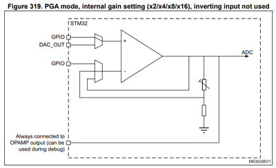

I would prefer to first consider using the PGA connected mode without external resistors or capacitors.
It would be greatly appreciated if you could provide detailed information on how to connect the circuit.

Hello @Seokjin,
The gain can be set using the OPAMP_CSR register, you can find the sequence to follow in the RM:
The procedure to use the OPAMP to amplify the amplitude of an input signal is presented hereafter (all bits in OPAMPx_CSR):
1. Set OPAMODE[1:0] to 10 (internal PGA enabled).
2. Set PGA_GAIN[1:0] to the selected PGA gain (2, 4, 8 or 16) in OPAMPx_CSR.
3. Set VM_SEL[1:0] to 1x in OPAMPx_CSR (inverting input not externally connected).
4. Clear VP_SEL to 0 in OPAMPx_CSR (GPIO connected to VINP).
5. As soon as OPAEN is set in OPAMPx_CSR, the signal on the OPAMP_VINP pin is amplified by the selected gain and visible on the OPAMP_VOUT pin
Connect the input signal to the non-inverting pin of the OPAMP.
