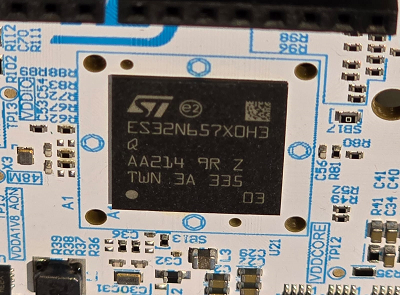

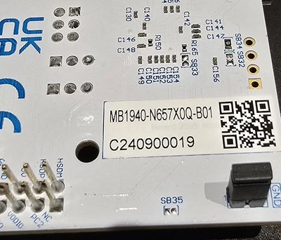

I think it's due to the revision of the processor, the 'Z' revision has the LPTIM4 in the Errata, whereas the 'B' does not.

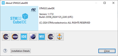

I believe I am doing everything right. STM32CubeIDE is upto date.

Hi @exarian
I recommend that you purchase a recent board version that includes an STM32N6570 Revision B.
The board reference should be MB1940-N657X0Q-C02.
https://www.st.com/en/evaluation-tools/nucleo-n657x0-q.html#sample-buy
