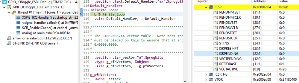

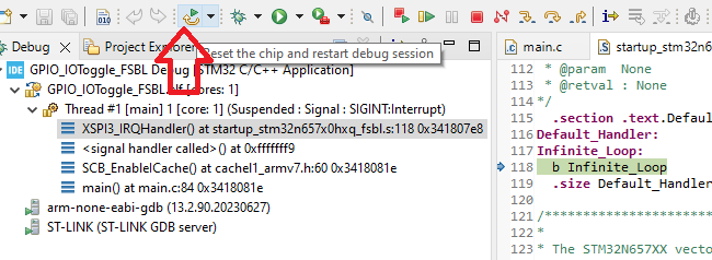

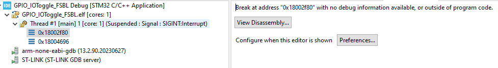

I am trying to get a simple program working on the STM32N6 Nucleo board, however when debugging an interrupt
occurs causing the code just to get stuck in the Default Handler.
I am not sure what interrupt is triggering it.
This is most likely a 1 line fix, or some arbitrary setting I haven't found yet.

6. Click Run.. No LED flashing so Pause debugger
7. Resetting the Micro just freezes and the device never gets the first main() breakpoint. I was expecting it to return to Step 5.
8. Pausing at that point just shows the device is at some address.
9. We need to restart the debugger session from scratch:

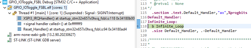

In summary, Pausing the Debugger on Step 6 shows its stuck. I don't believe it's anything related to XSPI3, as adding a handler for it, just makes the code get stuck in the XSPI2 handler instead. Also viewing the XSPI3 its all zeros.

My answer is generic not related to USB or FreeRTOS. If you have that behavior, it means you have an interrupt that is firing without any IRQ handler defined.
2025-02-07 10:09 AM

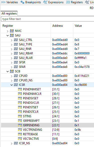

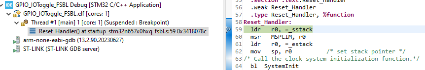

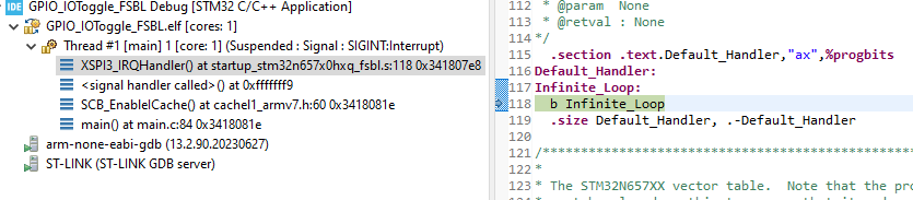

Thank you. If I put a breakpoint in Reset_Handler, and check the SCB, there is a Pending interrupt already immediately on powerup.
Clicking Run, and Pausing, It just shows that the VECTACTIVE = 0x9B.
I haven't changed the example project, I'm just trying to get it to run. This is on the STM32N6 Nucleo board.
No hardware has been modified, besides Boot1 being changed to 3.3V.
The STLink firmware has been updated to:
I've used other STM32 variants before such as the STM32H7, but have not ran into these issues. Especially not on a Dev kit.

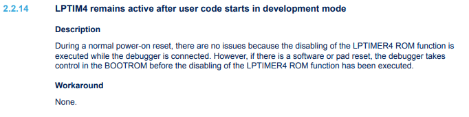

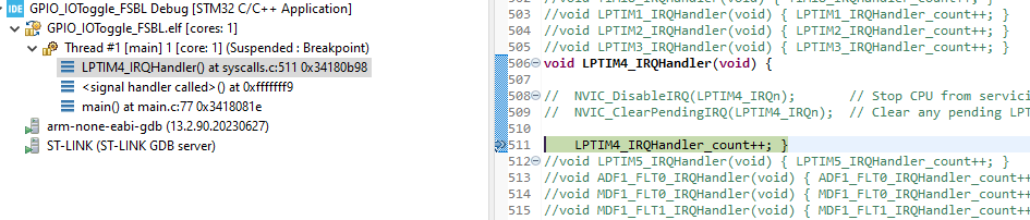

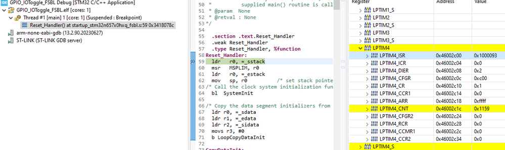

2025-02-07 11:22 AM
I've figured out that the interrupt which is being triggered is for LPTIM4.
I have not added this to the project so it was a real surprise.
It is disabled in the IDE config.
Checking LPTIM4 on Reset, shows that it has been configured and its running.
I am assuming that the debugger uses it as when I disable the interrupt, then the debugger just crashes shortly after.
I am not having much luck even with a simple Blinky, my thoughts are leaning towards having a damaged board somehow.
How can I build and program a simple blinky that just runs in RAM?
Lets google and see what comes up..STM32N6 Errata
Great, so the kit is not usable at all then?

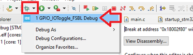

Please proceed as follows:
From the local directory C:\Users\yourname\STM32Cube\Repository\STM32Cube_FW_N6_V1.0.0\Projects\NUCLEO-N657X0-Q\Examples\GPIO\GPIO_IOToggle\STM32CubeIDE.
Double-click directly on .project (see below).
The example will be automatically imported into your STM32CubeIDE workspace. This should resolve the issue you described in step 6. Click Run. No LED flashing so Pause debugger.

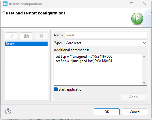

2) Now regarding the behavior of the suspend and reset buttons, the behavior of the reset must be modified, because after a system reset the BootROM has restarted, and we must inform the STLink GDB server to set the program counter (pc) and stack pointer (sp) registers to the correct addresses. This can be done by changing the Restart Configurations settings.
Then changing the system reset by a Core reset, and add the correct addresses for sp and pc as below:
Here pc = 0x34180404 corresponds to Reset handler and 0x341FFD00 corresponds to the beginning of stack in RAM. This configuration can be applied to FSBL but must changed for other execution context. For that you must refer to the corresponding linker file.

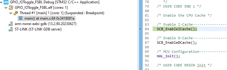

With these settings you should be able to debug, suspend and restart the code (note the first breakpoint at SCB_EnableICache(); take 1.seconde after pressing reset/restart icon.
Let me know if it helps?

I added the Reset Configuration commands, then Reset using the button in the IDE.
The LPTIM4 issue went away and the While (1) could be entered.
The LED 1 turns On, however the code seems to get stuck on the HAL_Delay function.

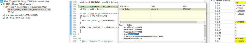

There appears to be a stack corruption that occurs when stepping into the HAL_Delay()
The Delay argument jumps from 100 to 0x34180771, which is closer to the PC value.
