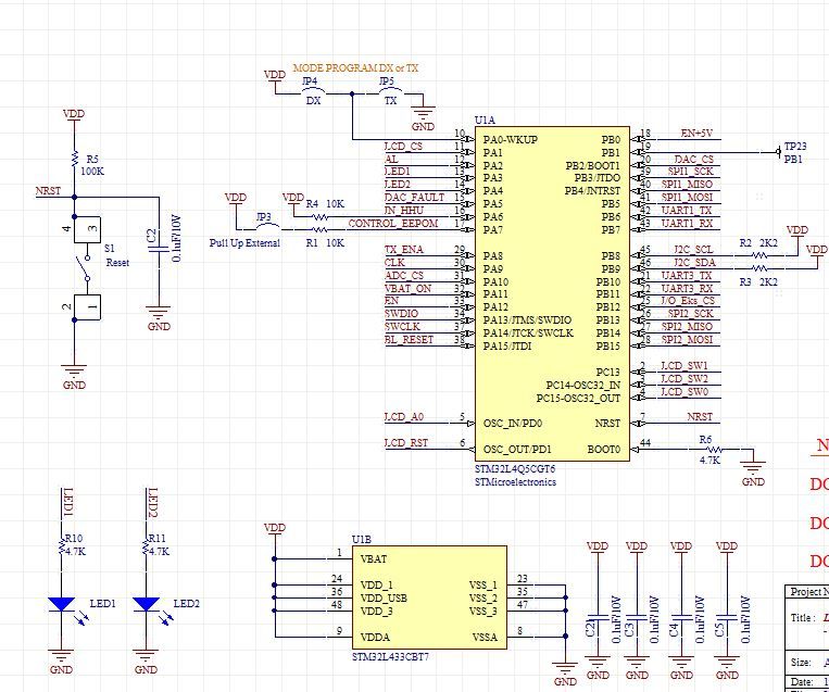

here is the schematic:
How to achive the current consumption like the datasheet about 300uA?
