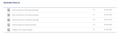

You can find the Schematic board in the CAD Resources of STM32L476G-EVAL.

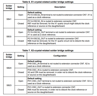

I advise to check the solder bridge, for that I recommend you the UM1855.

Thanks for pointing me to the CAD files. I still don't understand why it's not working. The solder bridge settings for X1 (SB41/SB33) are exactly like the X2 settings (SB24/SB23). By just powering the board, should both crystals be working, or does it have to do with firmware as well?
