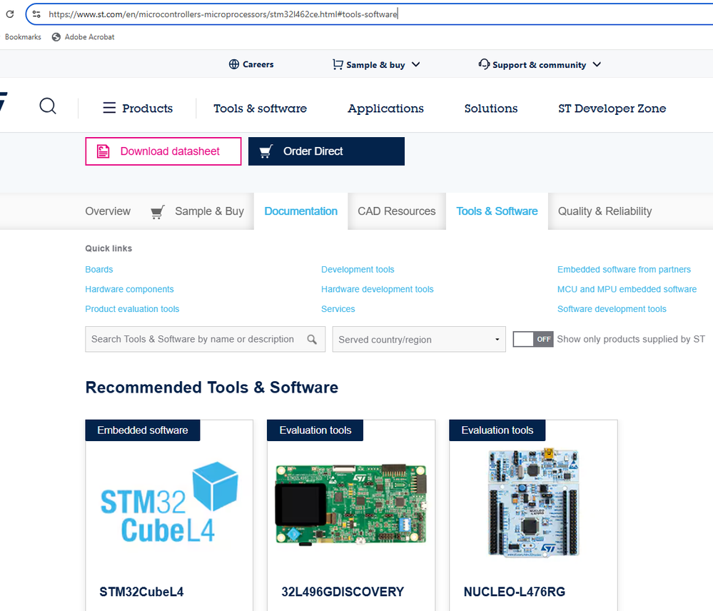

For any ST product, start at the Product Page:
https://www.st.com/en/microcontrollers-microprocessors/stm32l462ce.html
Go to the 'Tools & Software' tab:
https://www.st.com/en/microcontrollers-microprocessors/stm32l462ce.html#tools-software
There you will see all recommended supporting tools - including dev boards:
4 REPLIES 4

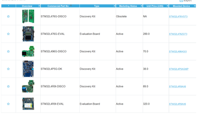

TDK
Super User
There is no board with that exact chip. Here are all of the ST boards with STM32L4 chips:
