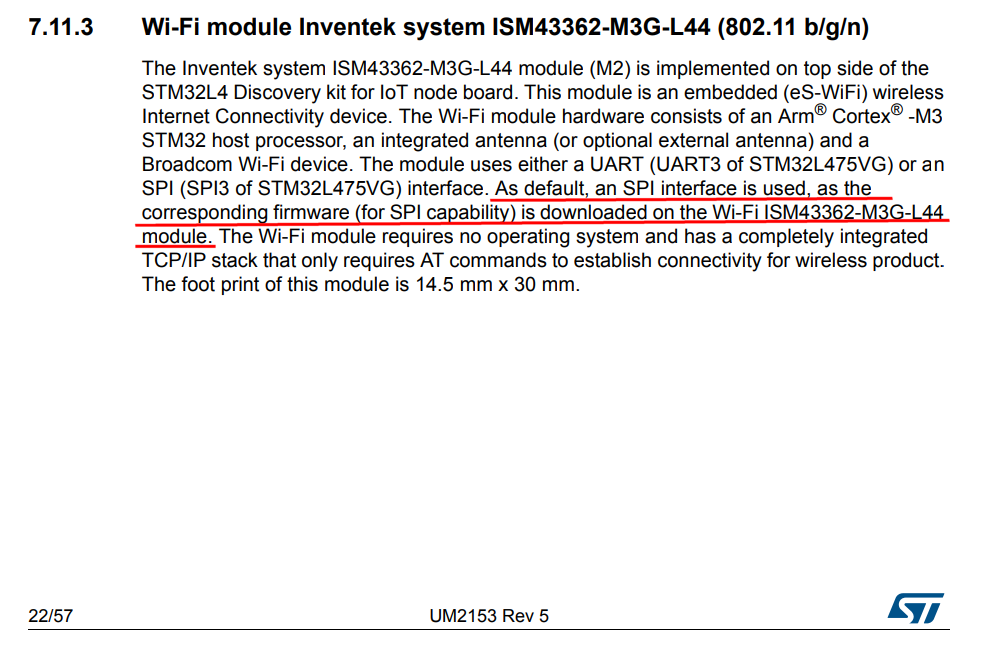

It's not entirely clear, but the board's User Manual suggests that the WiFi module firmware may be SPI-specific:
Again, Inventek and/or the module documentation should clarify that...

I have already gone through the documentation of both, the stm32 board and the WiFi-module. Other than the specific UART settings to use, I am unable to find any information. I think maybe the UART firmware needs to be flashed to the WiFi module. But how can I do that when it is connected to the STM32-board?
Thanks for the quick replies!
