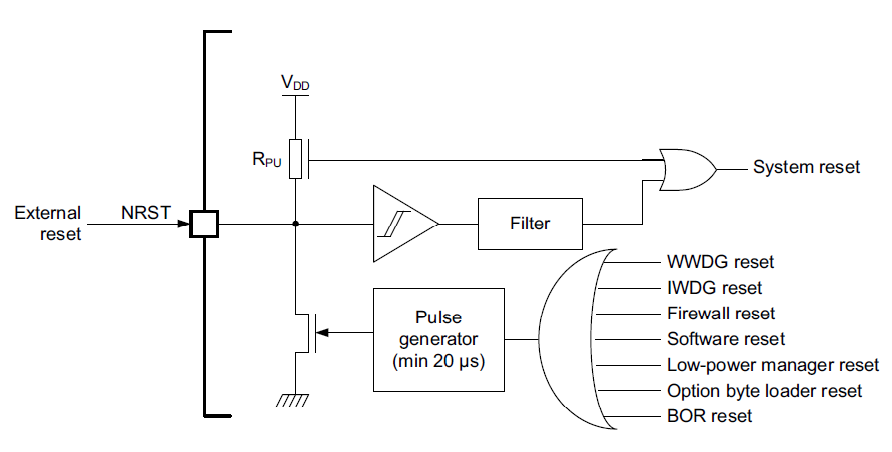

I understand the possible reasons for reset as per following image

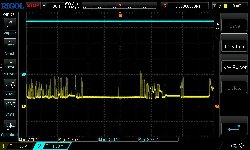

The voltage on reset pin is varying however the supply voltage is clean, you can refer the following image.
