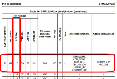

I have found those but when I compare the pin description in the first pic from: NUCLEO-L073RZ | Mbed
with the one provided in this datasheet:Datasheet - STM32L073x8 STM32L073xB STM32L073xZ - Ultra-low-power 32-bit MCU Arm<Sup>®</Sup>-based Cortex<Sup>®</Sup>-M0+, up to 192KB Flash, 20KB SRAM, 6KB EEPROM, LCD, USB, ADC, DACs
I find the pins order is different..

As @STTwo-32 said, the datasheet lists pins for all possible package variants; the ones you highlighted are only available on the UFBGA100 package (Red) - they are not available on the LQFP64 package (Blue) used on the Nucleo board.

In the case of the pin highlighted in yellow:

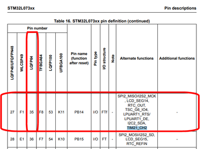

If you want to access the TIM21_CH2 Alternate Function on the Nucleo board, it's also available on PA3 and PB14:

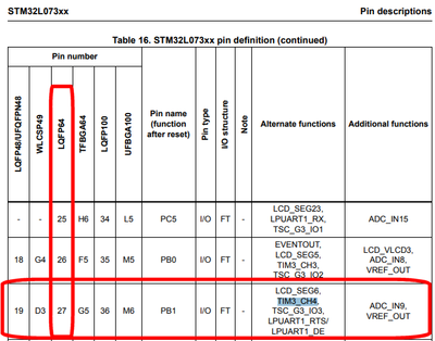

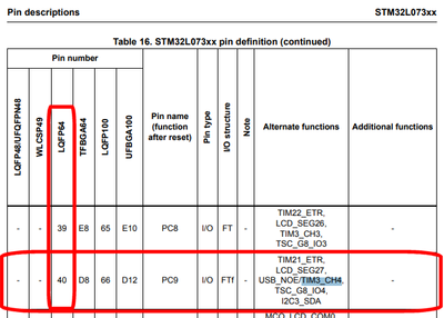

Similarly, the TIM3_CH4 Alternate Function on the Nucleo board is available on PC9 and PB1:
