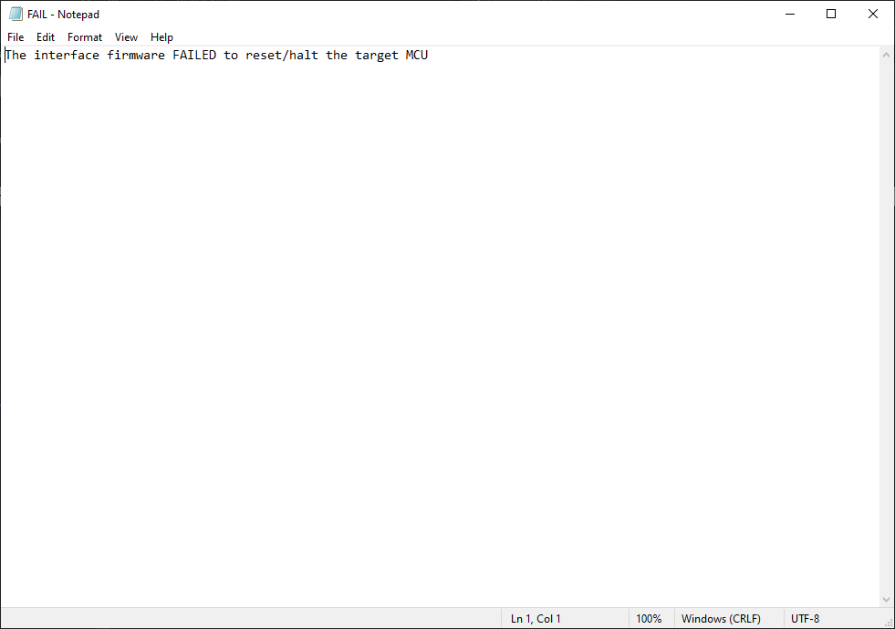

I get this file in my board. What is the problem?
Updated all drivers, tried setting BOOT0 to high and then updated them but still nothing, any ideas?
P.S.
I tried to run one code was working fine. When tried to load other then this happend.

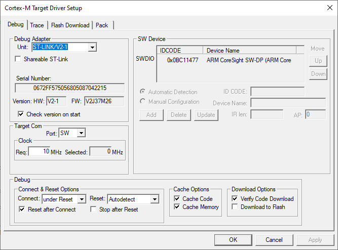

In STLink settings, change the reset options. Try "connect under reset" and / or use "hardware reset".
2020-12-12 9:51 AM
Just do what you tell me:
But get this error:

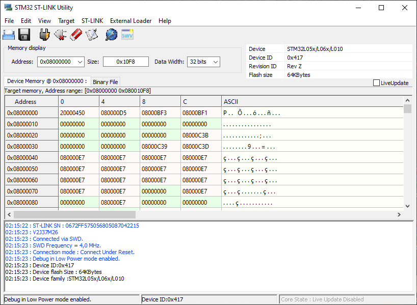

No man still error. I think the problem is somewhere else. I tried under reset, pre-reset, normal. Still errors.
But I can connect to stm32 ST-LINK UTILITY
But in KEIL program can't connect
2020-12-13 7:13 AM
Select a slower connection speed
