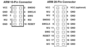

I figured it out. I was using the general pin out for the st-link clone and my particular one has a different pin out.
2020-12-10 6:11 PM
If you've tried everything I don't know what to suggest.
What specific error are you getting?
What board is the STM32F103C on?
Are you sure this isn't a fake chip?
How have you wired this up?
2020-12-10 6:29 PM
2020-12-10 7:43 PM
The "Not Connected" type error tends to indicate not connected properly, or not powered in a way that the chip is functional and responsive.
Those pin number don't relate to ST-LINK connectors, I'm familiar with. Please point to specific sites you're referring too.
What board are you connecting too?
2020-12-11 6:35 PM
