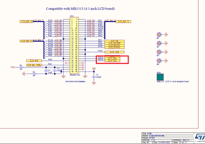

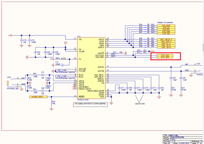

I am not able to understand the pin mapping in stm32h7b3i-dk (default pin mapping). I wont be using stmod+ but I need to use analog audio input (3.5mm Audio jack in) . By using the default set of pin mapping is it possible to use TouchGFX monitor and analog audio input without pin conflict? I tried to check this out myself my I am slightly confused about this.

The only ressource I can see from the board's schematic is the I2C4:
The Audio codec:
The LCD:
But since it's an I2C I don't think it's an issue. The mux is managed by I2C device address.

2025-01-29 10:53 PM
Thank You so much @mƎALLEm . I had my doubts cleared now, really appreciate your support .
